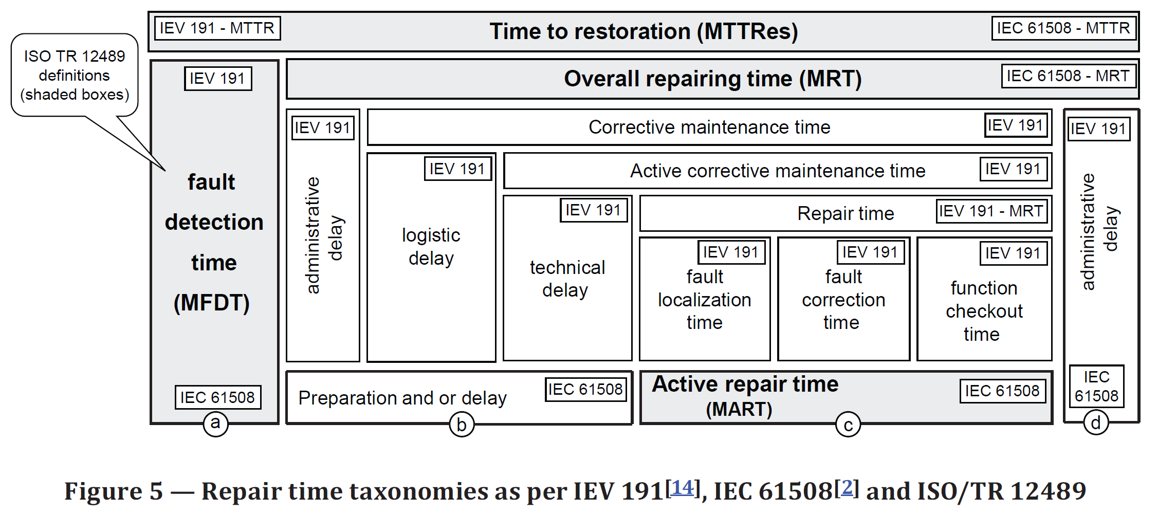

    Hi Luis,
    I think from SMRP Best Practices, travel time is already included as per attached photo.
    Thanks

    Hi Ahmed, thank you for sharing the diagram.
    Beyond the visual representation, the key point is the purpose of MTTR and the system property being evaluated.
    The diagram explicitly separates the "Get maintenance technician on site" phase from diagnosis and repair activities. If the intention were to include response or travel time within MTTR, the logical starting point would have been something like "call to maintenance." This separation clearly suggests that organizational response time is distinguished from technical repair time.
    From a maintainability and inherent availability (Ai) perspective, MTTR starts when the technician arrives on site and ends when the asset is restored, in line with SMRP Best Practices and the classical maintainability approach.

    From my perspective, MTTR becomes a much clearer and conceptually sound metric for assessing inherent maintainability when it excludes technician travel time.
    I can even accept considering spare parts delays in certain scenarios, for example when a specific brand or piece of equipment does not have global stock availability, provided that the minimum spare parts stock for the operation has been properly calculated. In such cases, the remaining delay is not the result of poor maintenance practice, but rather a characteristic of the asset and its supply chain.
    What should not affect the inherent characteristic of the machine, in my view, are the organizational delays specific to each company, such as response time, mobilization, internal logistics, authorizations, and similar factors. Including these elements ultimately "contaminates" the assessment of the equipment's intrinsic maintainability with variables that are external to the asset itself.
    For this reason, the SMRP illustration shown on page 83-where MTTR starts when the technician arrives at the equipment-appears more coherent and better aligned with the concept of inherent maintainability.
    To complement this approach, in practice I find it necessary to rely on other standards, such as PD CEN ISO/TR 12489:2016, which allow a more detailed breakdown and measurement of the different time components within a shutdown, using indicators such as MRT (Mean Repair Time) and MART (Mean Active Repair Time).
    In my view, this remains a gray area where SMRP has a clear opportunity to provide further clarification and stronger guidance in future publications.
