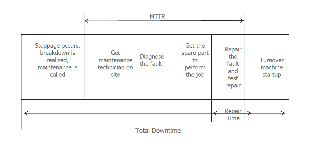

    I think from SMRP Best Practices, travel time is already included as per attached photo.
    Thanks

    Hi Ahmed, thank you for sharing the diagram.
    Beyond the visual representation, the key point is the purpose of MTTR and the system property being evaluated.
    The diagram explicitly separates the "Get maintenance technician on site" phase from diagnosis and repair activities. If the intention were to include response or travel time within MTTR, the logical starting point would have been something like "call to maintenance." This separation clearly suggests that organizational response time is distinguished from technical repair time.
    From a maintainability and inherent availability (Ai) perspective, MTTR starts when the technician arrives on site and ends when the asset is restored, in line with SMRP Best Practices and the classical maintainability approach.
