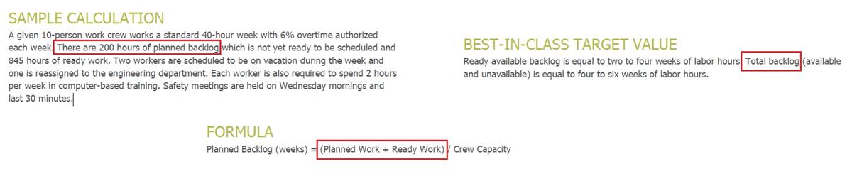

Thank you for the clarifications provided.
Based on the explanations, my takeaway is that in the context of SMRP Best Practices, Planned Backlog (as defined in Metric 5.4.8) is being used as an operational term to represent the total volume of planned work, regardless of its scheduling readiness. In other words, when expressed in weeks, Planned Backlog effectively represents the Total Planned Backlog, composed of both Planned Work (not yet ready to be scheduled) and Ready Work.
From an operational workload-horizon perspective, this approach makes sense, since excluding ready work would underestimate the actual demand against available capacity. However, from a conceptual and diagnostic standpoint, this terminology can be misleading, as planned backlog and ready backlog represent different maturity levels within the work management process.
For organizations seeking greater clarity in planning and scheduling maturity, it may be beneficial to explicitly distinguish:
- Planned Backlog (not ready).
- Ready Backlog.
- Total Backlog.
While still using the SMRP metric as a consolidated horizon indicator.
This distinction preserves the practical intent of the metric while improving analytical transparency and communication within maintenance and reliability organizations.

While reviewing the SMRP Best Practices (pp. 202–204), I noticed a potential ambiguity that I would like to open for discussion.
In the sample calculation, planned backlog is explicitly described as work not yet ready to be scheduled, and ready work is treated as a separate category. However, the formula for Planned Backlog (weeks) sums Planned Work + Ready Work, and the Best-in-Class Target Value later refers to Total Backlog (available and unavailable).
Conceptually, planned backlog and ready backlog represent different levels of work maturity within the work management process. From that perspective, the formula appears to be calculating a total backlog horizon, rather than planned backlog in the strict sense.
My question for the group:
Is SMRP intentionally using "planned backlog" as an operational synonym for total backlog (planned + ready) when expressed in weeks, or would it be more appropriate to distinguish these as separate indicators to better assess planning and scheduling maturity?
I am interested in how others interpret and apply this distinction in practice.
