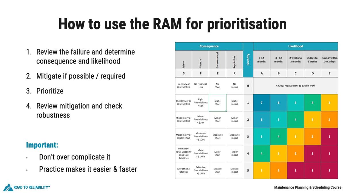

Hi Tatiana, what I have used myself for many years and now teach to our clients is the use of a risk assessment matrix for new maintenance work requests:
Each morning new work requests are assessed by a small group consisting of both Operations & Maintenance personnel for the potential consequence and the likelihood. That risk sets a priority and if you want it can also be used to set a required completion date.
Not only does this then give your maintenance planner a more robust priority to work with, but it is also key in reducing the number of jobs that are allowed to break into the Frozen Weekly Schedule.
Another method would be a RIME matrix but I prefer the risk-based approach as it is less mechanistic and forces a brief discussion.
As for updating your mobile equipment criticality ratings, I would suggest the first step is to be very clear about why you want to do that, and what you expect / want to get from doing the work. I have seen a lot of people spend huge amounts of time on risk-based criticality ratings that in the end could have been achieved a lot quicker (with a different approach) and did not generate any clear ROI.
