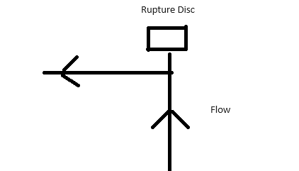

    We are having multiple failures (at least 10)  of rupture discs in four skids of the same design and wanted to seek out your advice.  The set pressure of the discs are 100 psig but they tend to burst around 50-60 psig after a period of operation.
    Below is a rough sketch of the location orientation of the burst disc. It is installed at a location of a tee that the liquid hits it directly before changing path at a right angle. The disc is protecting a heat exchanger upstream of it which has a centrifugal pump further upstream. The pump feeds through the bottom of a CIP tank.

    Hey Nimesh,
    Are the burst disks designed to redirect flow like that? System pressure + velocity pressure may be causing the 100PSIG burst condition, especially if there is some system pulsing. Typically I haven't seen these installed in this orientation to the flow.

    Connor,
    The setup of the rupture disc is actually odd and something that I had not seen before. We had the same suspect if the flow deadheading the rupture disc before making the 90 degree turn has something to do. I dont think the disc is rated for redirecting the flow. However, I am curious about the velocity pressure that you bring up. Is there anyway to quantify it?

    Are the rupture discs Forward Acting (e.g. Forward Acting Scored Rupture Disc (FAS) - OsecoElfab) or Reverse Acting (e.g. Precision Reverse Operating Rupture Disc (PRO+KRGL) - OsecoElfab)? If the former, they can be susceptible to premature ruptures as fatigue from cyclic loading/pulsations causes them to weaken along the score lines. The reverse acting discs are less susceptible to fatigue since they fail in compression instead of tension.
    The piping arrangement you showed is unusual since I usually see discs out of the direct flow path but if you can't fix the installation location, I would look at a reverse acting disc option if not already installed.

    Regarding water hammer, there is a dip tube further downstream going into a tank. however, the path back to the disc from the dip tube is lengthy and not straight enough for the wave to propagate all the way to the disc. So, I dont think downstream hammer is a likely cause. However, I am curious to learn about the effects of the direct kinetic impact on the disc as Connor has suggested.
    Also, I dont think its an installation problem as it is recurring issue and based on the problem at multiple skids with the same configuration, the design is likely the issue.

    Using Bernoulli's equation you could estimate the stagnation pressure experienced at the burst disks, it may give you an idea of how close general system conditions are to the burst condition. This link has some background: https://www.princeton.edu/~asmits/Bicycle_web/Bernoulli.html#:~:text=The%20stagnation%20or%20total%20pressure,dynamic%20pressure%20measured%20far%20upstream.
    Matthew's post has some great points to consider as well. I've seen multiple failures in a row from technicians stepping on the burst disks after installation just because of the awkward space they had to work in.
