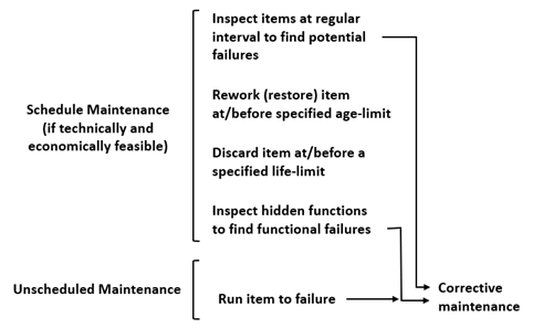

    How does your organization define routine, corrective and reactive maintenance? Does your organization use alternative terms to routine, corrective and reactive?
    Lately, I've been restudying the design and decision logic to maintenance operations as it is underpinned by RCM. I found that my definitions were getting sloppy with time-to the point of feeling a bit embarrassed and hoping people have a short memory of some of my more recent commentary.
    The restudy has shown me that how we define routine, corrective and reactive maintenance would be an interesting thread.
    You can download the free pdf-book, Reliability-Centered Maintenance, by Nowlan & Heath, 1978 at https://coconetinc.files.wordpress.com/2016/12/reliability-centered-maintenance.pdf

    Richard, thank you for raising this topic and for posting the link to the 1978 Nowlan & Heath book.
    The three task type labels you state, routine, corrective and reactive, are very commonly found / used.  Looking at chapters 3 and 10 in the Nowlan and Heath​ RCM book there is a much more distinct classification presented with a solid basis for those classifications.  Working to determine "asset strategy" effectiveness as well as asset characteristics such as reliable life I find that we are forced to try to infer more from these limited common "work order type" labels than they are designed to represent.  More specific task types, if they could be broadly adopted would help.  However I believe that the real solution is to have at least three separate characteristics of an "event" defined.  One to indicate the intent of the task, one to indicate whether the asset was repaired or replaced in part or completely and one to reflect the work schedule impact related to the event.  To that point, Reactive clearly isn't a "task type".  There may be more factors that would be useful and this initial set does not even touch on the indication of failure mode, which goes beyond the nature of the task or event.
    As the global industrial businesses evolve along with the increasingly capable digital tools, clarity in classification will become ever more valuable.

    Roger makes an important point that reactive is not a task type. His point is proven by the fact that there is no reactive in RCM--just like no crying in baseball. Therefore, should reactive be defined on some other basis such as case for:
    • An appropriate maintenance task has not been designed in recognition of the significance of the failure to safety, environment, operations or excessive cost if allowed to run to failure?
    • Failure to execute with the designed appropriate maintenance task.
    • Gaming the system as a means to put a repair at the beginning of the line--although not justified.

    The diagram is a summary of the RCM framework using the exact words of Nowlan and Heap. Do you agree that is correctly depicts N&H's framework? As I prepared it, I noticed that the framework is largely is without definition. Instead, it expresses the types of work as action-by whatever we want to call it.
    Where do the various definitions of this thread plug into framework? Can we think of any maintenance types that are not explicit or implicit to the framework? Are there notes you would add to it?

    Richard, I normally teach that the distinction between reactive and corrective maintenance is whether the task will interrupt operations and availability. You are correct, reactive maintenance is not found in the original RCM literature (at least not that I am aware). However, in practice, many organizations realize that not all corrective maintenance is equal. Some interrupt operations and some do not. Plant reliability through redundancy is one design tactic used to build this protection into critical systems.
    To further pile on, I see the term reactive maintenance commonly confused for the result of too much corrective maintenance, which creates a reactive culture. A reactive culture soon makes all corrective maintenance reactive by choosing to interrupt operations, even when potentially unnecessary. Every failure becomes high priority, every failure must be immediately corrected, and every failure diverts resources in a reactive culture. Soon, little investment is made in prevention. This has become the maintenance environment/concept/philosophy for some organizations. To further distort the topic, some folks actually justify this approach by further confusing the concept of a reactive maintenance culture with that of very successful production methods focused on correcting defects immediately upon discovery so as not to build defect into the product or process and reduced post-production rework. This can be very disappointing....we must not put all work types in the same model.
    Every maintenance and operations manager should ask themselves if the corrective maintenance item is immediately necessary in order to restore valuable function. This is the essence of the "C" (Criticality) and "E" (Effect) in FMECA. It is also the final criteria in most structured Reliability Analysis...did we cross a line in the "criteria" sand that causes operations to be critically interrupted without correction? Does the ship need to turn around? Does the production line have to stop? Does the plane need to land? Or can we schedule the corrective action during planned equipment downtime?

    Lucas, we agree on every point you make. We are recognizing the difference of cases calling for corrective maintenance, but with different priority for action with respect to any serious consequence of the failure-if any. We also recognize the absolute importance that maintenance operations understand and make their decision on the distinction.
    Thank you for your point, "I see the term reactive maintenance commonly confused for the result of too much corrective maintenance, which creates a reactive culture." Worse is that so many times I see the perception, "corrective" maintenance bad, scheduled maintenance good.
