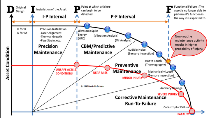

    Pro-Active maintenance could also be called Predictive maintenance.
    Predictive Maintenance (PDM) is different from PM in that PM's are generally, clean, replace, lubricate, replace, inspect (using 5 senses)
    PDM differs in that it is based on using technology to detect discrepancies in the operation of equipment before you can detect the problem with your senses (sight, sound, touch, smell, taste). The higher up on the P-F curve that you can detect the imminent failure, the more time you have to PLAN a replacement (on your time schedule, not when it finally gives up and fails completely).
    Systematic thermographic, vibration monitoring, ultrasonic.... can let you know FAR in advance of when the equipment is going to fail. These technologies can make a huge difference in your maintenance strategy if they are consistently utilized.
    As the graphic shows, it starts with a proper design.
    Installation plays a huge part, since studies show that most failures are a result of human error. The proper installation can greatly increase the time the equipment will operate before an incipient failure (still functioning, but at a diminished capacity)
    If the equipment makes it to the "P" point, (where a component is starting to fail), this is where you can FIRST start to detect it using technology (Viv, thermo, US...)
    Once it gets to where you can sense it yourself, it is nearing complete failure, and you are living on borrowed time and luck.
    Far better to detect early and change the component when you want to at a natural production down time rather than during an unplanned outage that impacts production.

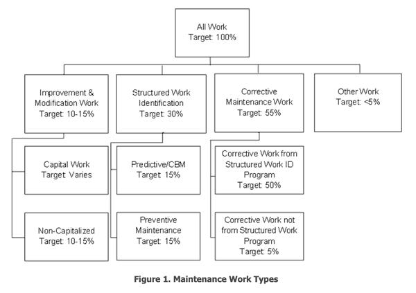

    SMRP Best Practices defines a difference - and there's even a nice picture!  Since you're asking the SMRP forum, as far as standards go, I'd align with this one.
    Preventative Maintenance are the actions performed on a time-based interval.
    Not to be confused with Predictive Maintenance (PdM) or Condition Based Maintenance (CBM) which the SMRP uses interchangeably - this is the stuff around assessing equipment condition.  Note that if a PdM/CBM activity detects something, corrective work will need to follow.  So the SMRP splits Corrective Work into 2 buckets - structured corrective work, which results from either a Preventative or Predictive maintenance activity, and unstructured corrective work, which is not.
    Now we get to Proactive maintenance - that's the work that is (1) Preventative work, (2) Predictive/Condition-based, and (3) Corrective work which is identified from a structured work program:
    The SMRP metric 5.4.2 Proactive work takes the sum of all of the labor hours from these 3 work types and divides it by the total maintenance labor hours.
