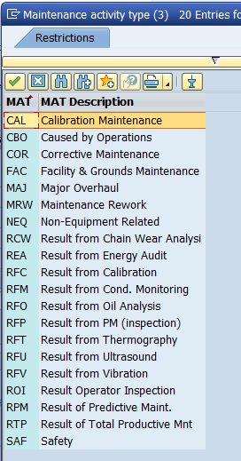

Functional failure is not meeting design therefore when there is any loss of production the corrective work is reactive. I have had many NO created as proactive because the equipment was still online however production was reduced.
Early in our SAP years at a former company, we generated a general WO to capture all hours no tied to specific WO. This created two problems and I am adding to Terry's comments.
1. Inflation of hours on jobs which falsely decreased wrench time. Tavel, meetings and training were some of the hours captured. No maintenance was performed but the WO was a maintenance type and affected the wrench time calculation.
2.Many hours of small jobs such as tightening a leaking flange or changing absorbent pads under a leaking valve were placed under the general WO so not captured in the historical record of specific equipment creating a better than true historical record. Your question does not imply you are using a general WO. This is so all may learn from our mistake.
