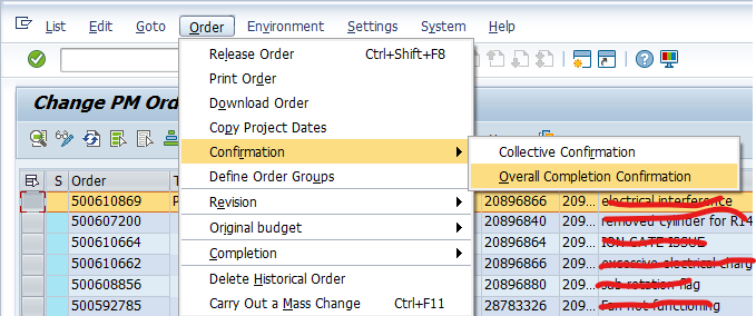

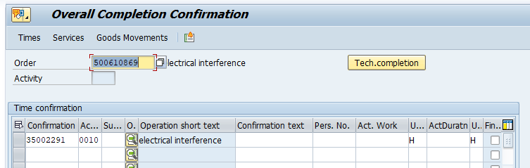

Dear Sirs,
Greetings for the day! We are providing maintenance services to our client plant, which is a primary aluminium smelter. The client has installed SAP PM module for logging the maintenance work that is being done on the site. For gaining understanding of the quantum of work that is being done, it is needed to calculate the man hours that are expended in each job. Does SAP have capability for doing the same? As of now, we are creating work orders on SAP and the intervention duration is getting calculated on SAP. For calculation of manhours, we are doing it offline in a spreadsheet. I would like to explore any capability that SAP has so that it can come from SAP directly without having to spend time on calculations offline. Any pointers to this end would be great. Thanks in advance!
