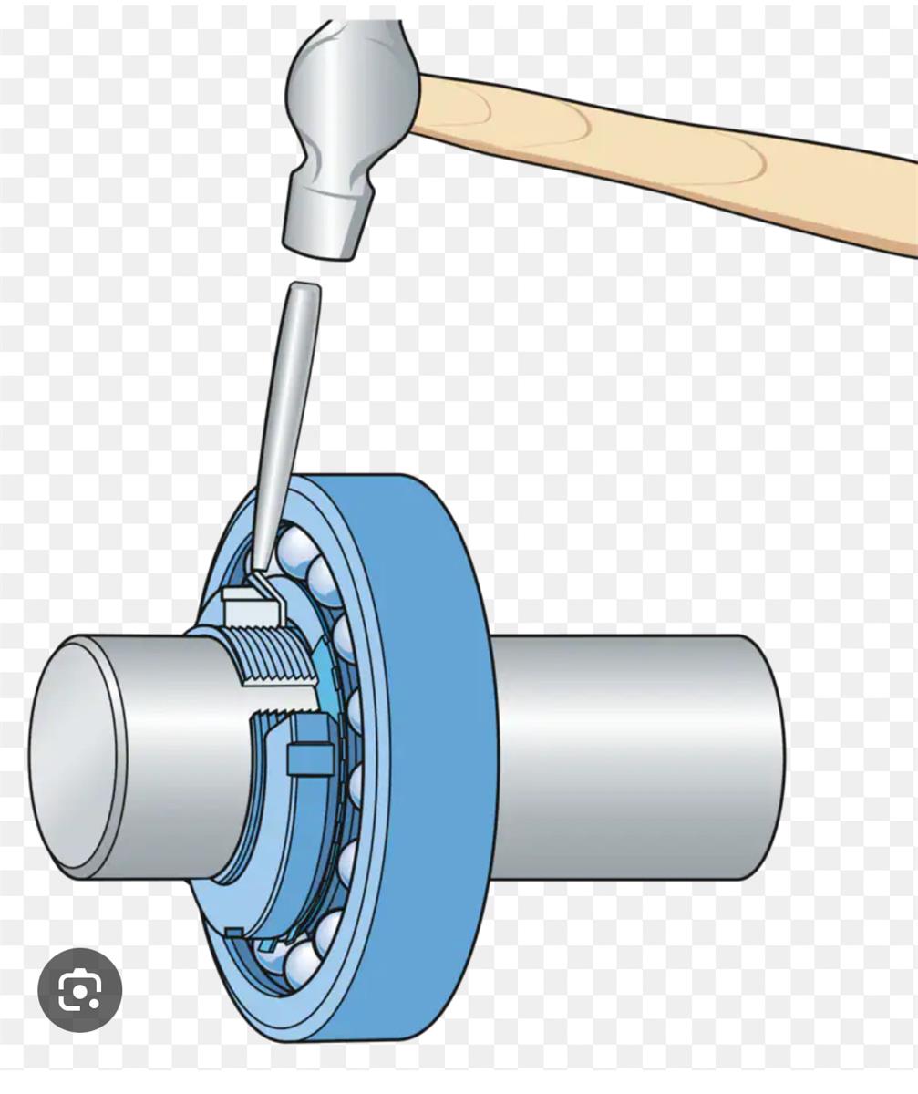

- Never use a cold chisel to drive the lock nut. Use a C-spanner or impact spanner.
