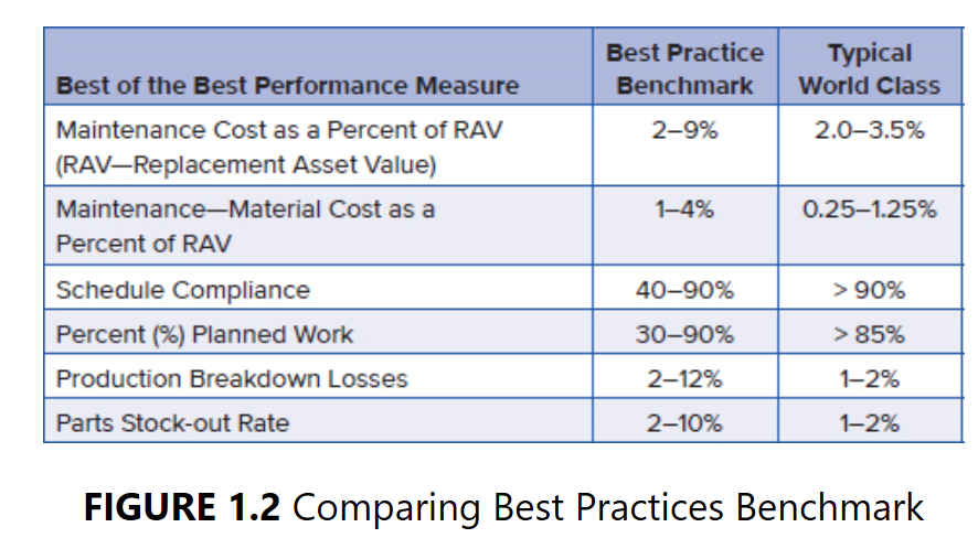

    I am in a similar situation but in the metals industry. Building a M&R program without critical spares, maintenance team, or historical backlog of failures. I am basing half my work from Ramesh's Guidelines and the other based on tribal knowledge in the plant.
    From M&R Best Practices:
    I don't work in Food and Beverage so I would assume your percentages would be higher.

    In the SMRP Body of Knowledge look at 1.4 Stocked Maintenance Repair, and Op Materials (MRO) Inventory as % of RAV. Pay special attention to the caution at the end.
    Here is my personal experience from two vastly different food manufacturing facilities. Total annual maintenance spend to RAV and MRO to RAV
    In a large liquid batch process facility (pumps, pipes, valves, and vessels) heavily automated. We were on the low side of this around 1.5%. Stocked inventory as around 2-3% of RAV
    At a more traditional food mfr facility (raw material grind/blend, form, cook, freeze, bag) with individual cell automation we were a little higher and closer to the middle of the best practices estimate, around 4%. I'm not sure what our inventory to RAV was, but I'm assuming it was in the 1%-1.5% range. Improvement projects were often centered around development of equipment standards towards installed equipment consolidation. We also had a fantastic planner and maintenance superintendent, and incredibly supportive maintenance/operations/plant mgmt.
